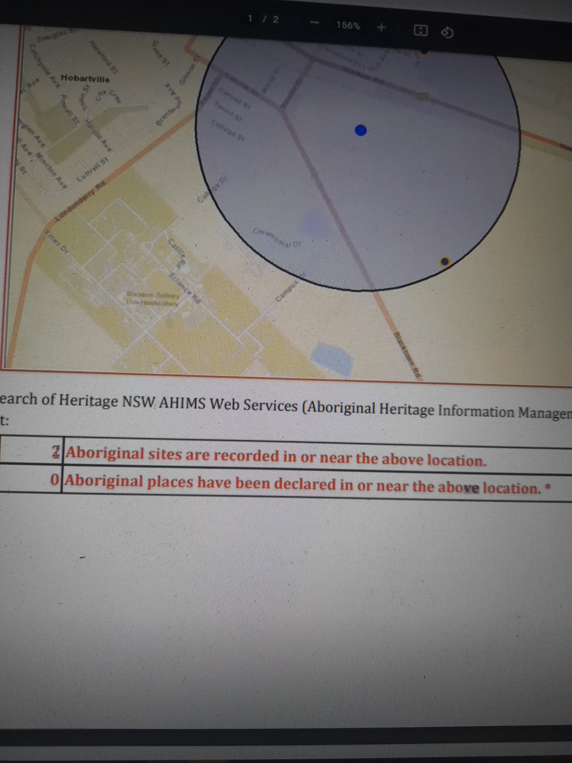

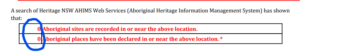

I want to read a particular cell value in the pdf i.e the value of the first row, first column if it is more than 0 i need to put a message box.
How do i do that?

The format of the PDF is the same always.
SearchResult.pdf (119.5 KB)

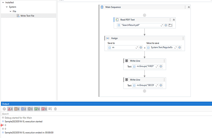

How about the following?
m = System.Text.RegularExpressions.Regex.Match(strPdf,"A search of Heritage NSW AHIMS Web Services \(Aboriginal Heritage Information Management System\) has shown\s+that:\s+(?<FIRST>\d+).*\n(?<SECOND>\d+)")
Then
m.Groups("FIRST").Value
m.Groups("SECOND").Value
Sample20230516-5L.zip (115.8 KB)
This works.
Thank you @Yoichi .
