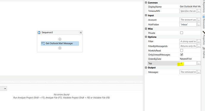

There are multiple ways for it.
set property top 1 like below

Which email client you have?
If it is outlook, you have to Configure the outlook in local system
Later you can use Get Outlook Mail Message

Actually I need to use get exchange mail message activity…so how to get the latest message through that activity.
Another method would be, once you read the emails, use the << MailVariable >>.headers(“Date”) and get the latest mail from there using a loop
So once you fetch the first one, break the loop
