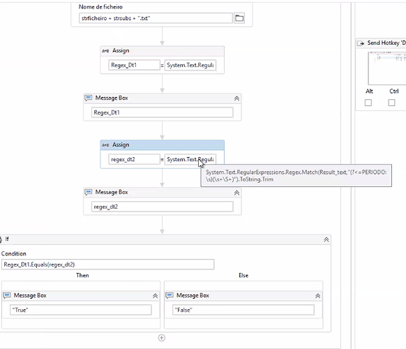

I need to store two dates that appear in my .txt file and check if they are the same or different to include a condition
For example:
I need to check if these two dates marked in yellow are the same or not

Hi, but I need to read the dates in my text file not convert
Could you share the sample Text file
Here is the workflow
Compare Date.xaml (6.5 KB)

In these two initial assignment activities, can I put a text reading activity? and I replace in the expression REG the variables by the variable of this text reading activity, correct?
Yes, You can use Read text File Activity
The first date (Regex Dt1) appears correctly, the second (Regex dt2) appears empty and not the date. And the only thing I changed was the variable, in both expressions.
I Change the expression in the second variable and Know works. Thanks for your help
@Gokul001 , I have seen your workflow. Can you explain why you use “(?<=PERIODO:\s)” this \s, while in case of “Regex_Dt1” you don’t use \s “?<=EMISSAO:” .
