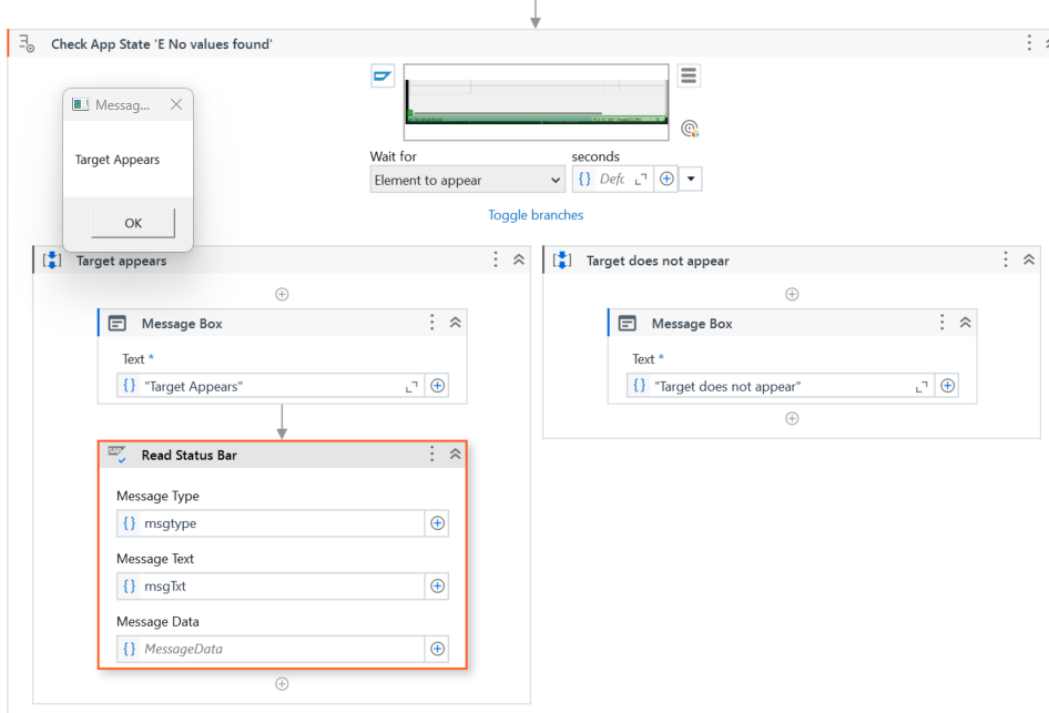

First, thanks for your responses and willingness to help. I’ve attached some screen shots to hopefully give a clearer picture of what I’m dealing with. The check app state is finding the status bar. Is the check app activity doing something different than Read Status Bar activity?

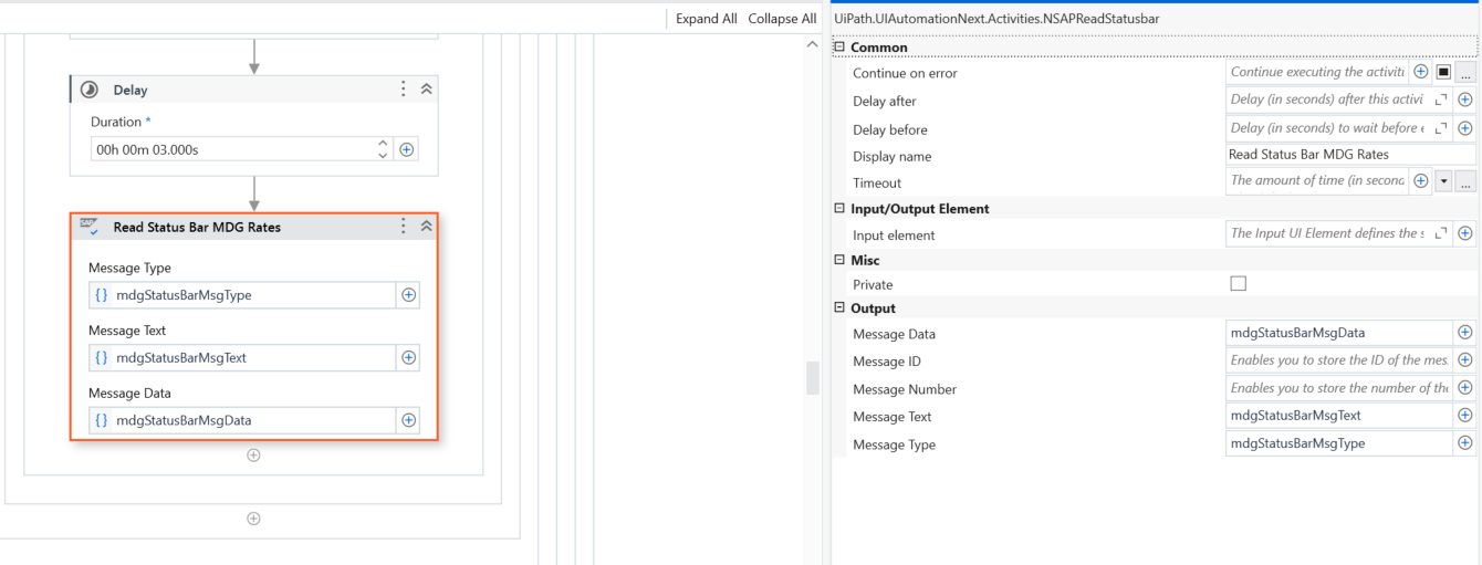

I nested another Use Application Browser activity and put the Click activity inside of it and it worked, but the Read Status Bar is still not able to find the status bar element. Also, I’m only a few months into using UiPath, so could you tell me where to/how to check the selectors of the Read Status Bar activity? When I add the read status bar activity to the use application browser “Do” panel, the only option I see are the properties and not any selectors.

if you open the properties panel you would see the selector option there
cheers
Sorry, but which property are you referring to as the selector?
@kevin.clark
This is interesting ..okay you can do one thing get the output element from check app stte and pass it as input element in this activity

I called Check App State and it went through Target Appears but it does not read the status msg Text / Msg Type.
