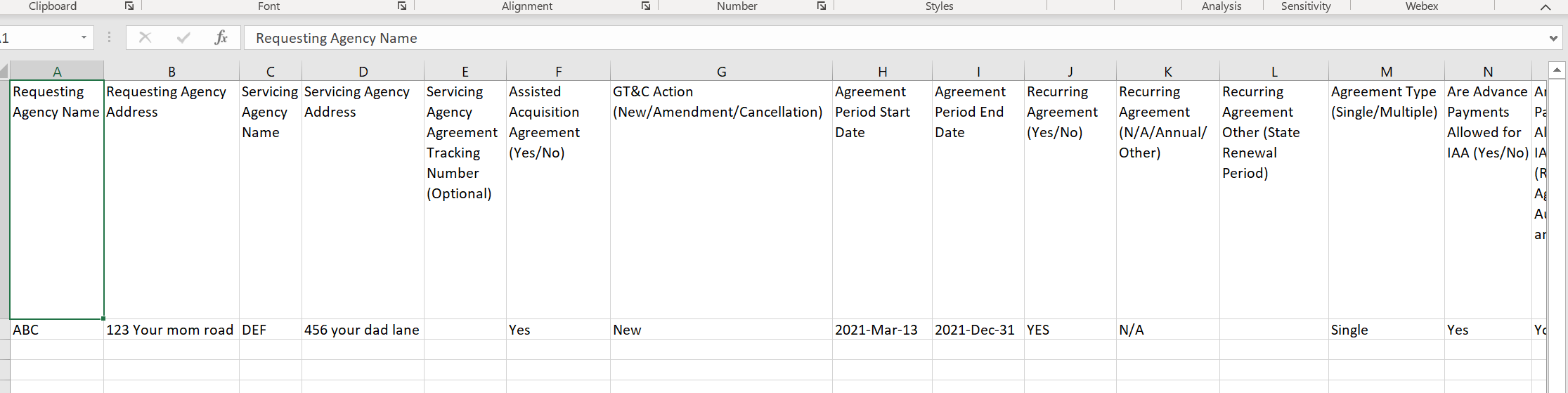

My read range is only reading the first column of excel spread sheet. Here is my settings for the activity:
Screen shoot of excel i am trying to read:
Hi @nicholas.harvey
I dont find any problem with that.
Can you share the excel with dummy data, so we can test from our side.
Thanks

I do not see anything wrong with your file, I can read all of the file columns. Test the attached workflow.
Maybe the path is wrong and you are setting up a different file that has only one column (?) just saying.
