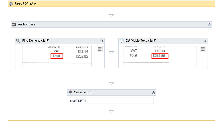

You Can use Anchor base activity, add Find element on left side and GetVisibleText activity on the right side.
result -
