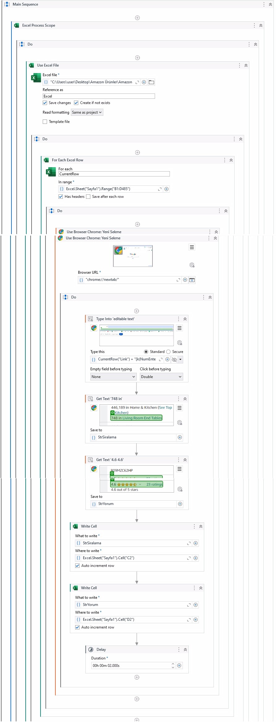

ı am trying to add these two data.
Thank you so much this is very important for me :slight_smile:

Hi @Emre_Toy
Please check below attached xaml
Sequence1.xaml (68.1 KB)
Regards

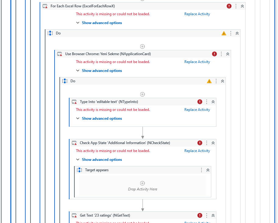

It looks like this…
Is this ?
Hi @Emre_Toy
Please update the packages to the latest versions and keep the runtime rule as lowest as applicable.
Please check whether you have below highlighted packages or not?
Regards

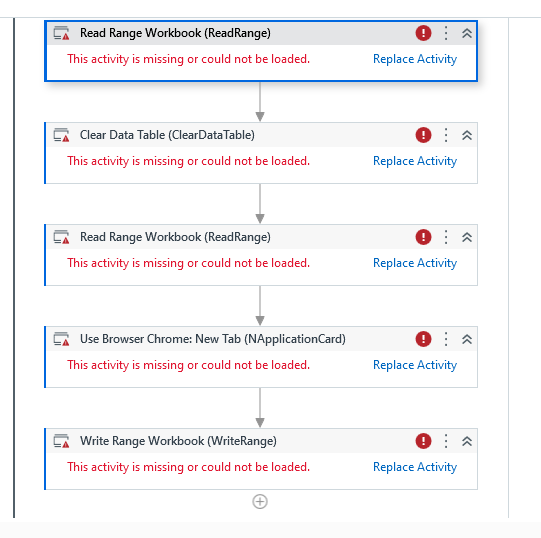

just one more question what is dt1 or dt2 ? and then everything perfect :slight_smile:
Hi @Emre_Toy
I have just gave the data table names as dt1 and dt2 for my reference. You can change the names as per the standards.
I have used the read range activity and gave the dt1 as the data table variable for the first read range activity so the dt1 stores the entire data present in excel and after that I have used the clear data table activity and because of that activity the data will be cleared from dt1 and then only the headers will be left for dt1 variable. So, for the for each (iteration row by row)process I need an entire data from an excel so for that reason I have used another read range activity and gave the output of that activity as the dt2.
Hope it helps!!
