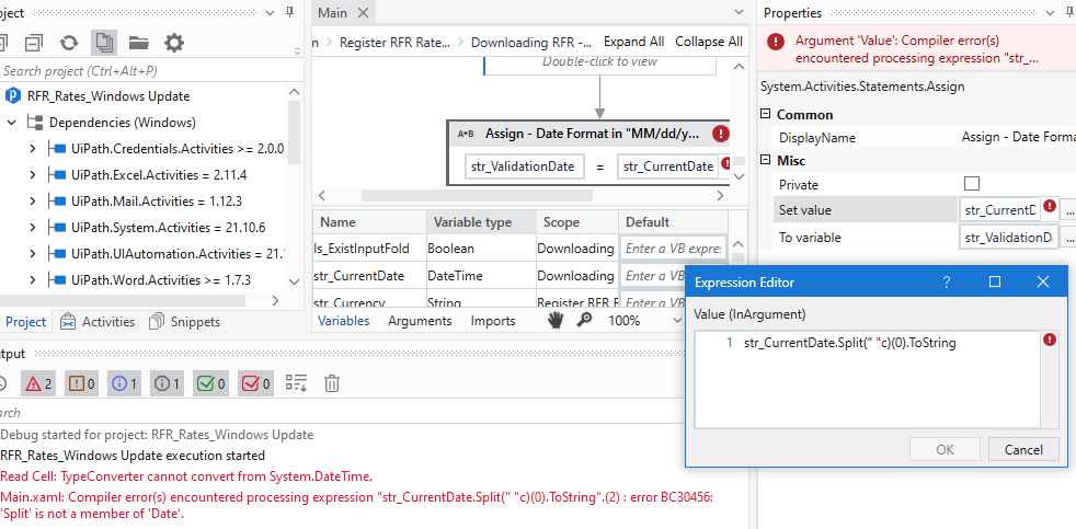

Read Cell: TypeConverter cannot convert from System.DataTime
Hi all, i am encountering an issue with my robot.
The variable type is set as generic value.

Hi @fernando_zuluaga
Another error appears if DateTime is used.
Previously i am able to run this robot, this error only happened after upgrading of UiPath to new pc.

That error is not related to this topic, looks like now you have to debug your process and start updating the activities and values
Regards
@marct
Once you change the datatype of the variable from
Generic value to datatime…
Your function split is not working as datetime cannot be split
Use str_currentdate.ToString("MM/dd/yyyy") to get the required date directly…you need not use split when it is datetime to convert to a string time in required format
