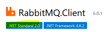

In one scenario (another Package not RabbitMQ…) where a package came with similar references
grafik
we did 1 RnD round with adding the
<AssemblyReference>netstandard</AssemblyReference>
and got it fixed. But only do it on the isolated RnD set
