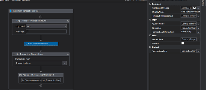

Hi All,
In my automation for a failed business exception, The queue item gets uploaded in the performer queue as "Failed.
But it’s still “In Progress” in the dispatcher queue. How do I change this?
Here’s my code.
I have added “Add transaction item and set status” it changes in one queue (performer) but not in Dispatcher.

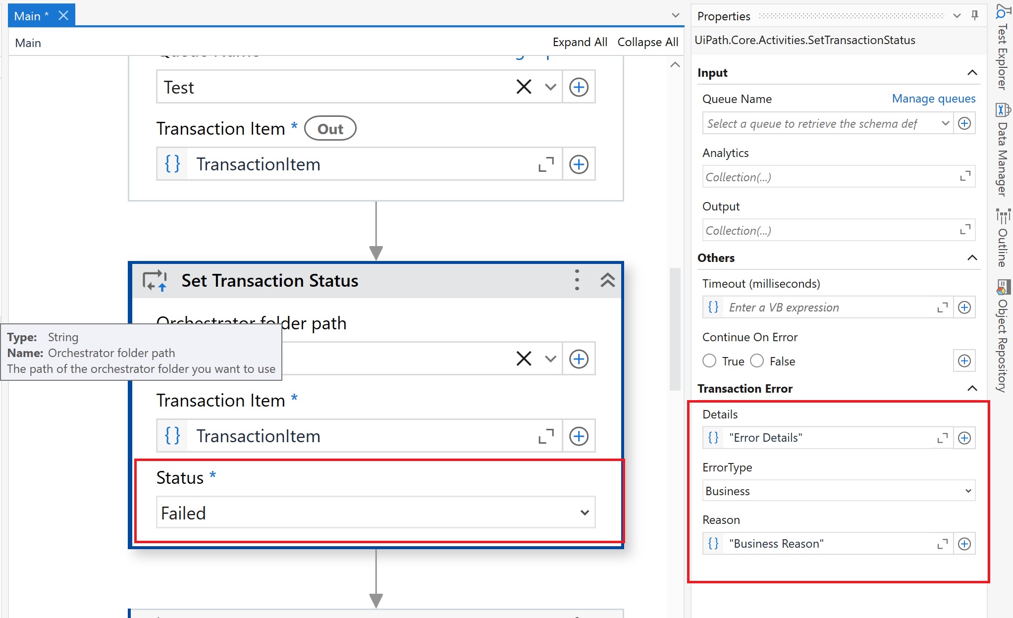

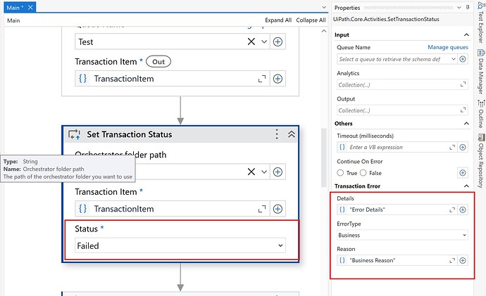

Use Get TransactionItem activity to read the item from the queue and pass the output to Set Transaction Item activity to update the status of it.
Use the activity “Set Transaction Status” and add the status “Failed” while providing the transaction error details as shown below.

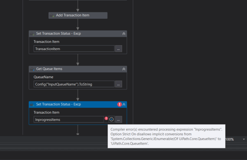

Thank you. I did this and got one error
@sharon.palawandram
Get queue items will give you enumerable of queue items…so you have to extract one …if you are sure that its only one item thats matching then use inptogressitems(0)
Thank you, this worked :smiley:
