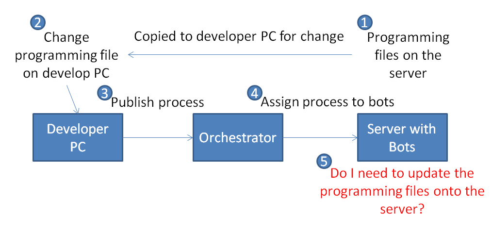

Hi everyone, i have a question regarding deploy packages from Orchestrator to the server where the bots are installed.
I have several servers installed with robots and i’m developing on my local developer laptop.
- If i publish the package to Orchestrator and want to download the package on the servers. Do i still need to copy my programming files / folders onto the server with the same path and folder structure or it’s done by Orchestrator automatically?
- If i published the package on the servers at first (so the programming files/folders already exist on the server) and adjust the programming files on my developer laptop. After the adjustment i publish the package from my developer laptop and assign the process to the robots on the servers. would the programming files which are already on the servers affect my published process? Do i need to overwrite the programming files on the server?
Maybe additionally, what is exactly inside the published package?
One additional question:
If I’ll need a additional mapping file to help me to automate the process e.g an excel file with company code and company name for SAP. If I publish the whole project and this mapping file is inside the folder where the “main.xaml” is located, would this mapping file also be in the published package? (Similar to the config excel file?)
