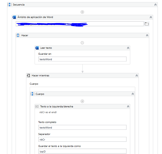

I tried to do this to keep the text, but the subject that by staying with the first value already discards the rest of the text. How could I fix it?
