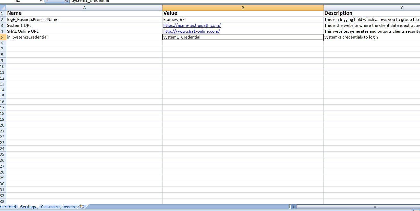

I went through the explanation given and have made changes in the same.Please go through the below points and help me correct if at error in creating at any point.
  1. Under config.xlsx file i have created the Name (in_system1Credential) and value (System1_Credential)
Is this the correct way??

  1. Looks fine.
  2. Orchestrator is fine.
