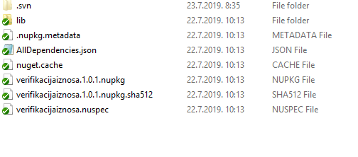

On the left folder is unpacked using zip and on the right using robot tray. When unpacked from robot try it creates all dependecies.json and some other files but when from zip it does not create that but some folders. Can you point me where I can find some explanation to this ?
It’s because robot is working similarly to Studio. It means robot also need to download dependencies and packages to work with project which requires such. But go to this zip-unpacked folder into lib\net45 folder and look what is there

Inside \lib i have:
Do need all of theese files for the project to work properly. If Yes then it has to be published from the robot tray??
Those are files needed to properly run project between Orchestrator - Robot and as you see there is also some encryption (SHA512) file. Those prevents from any kind of disruptions when project is running on robot I guess. In your case the project files from .net45 folder are only what you need. Based on then you can publish another .nupkg file from Studio anyway
