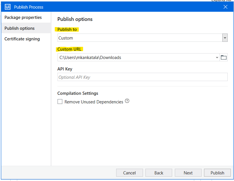

Hi @Byrnecut
Your question Is there any approach to publish the Project to the required tenant which out chaning the Tenant connection of UiPath Studio.
If my understanding is correct, then when you are publishing the project from studio. In Publish to dropdown select the Custom option, give the local folder path where you want to save the .nupkg file and click on Publish. The .nupkg file saved to the local folder.
Then login to Orchestrator → Select the Tenant → Click on Tenant option on Top left side → Go to Packages tab → Click on add packages → Select the same .nupkg file and publish.
This is also one of the process to publish the Project to the required tenant with out changing connection of the Studio with the Tenant.
Hope it helps!!
