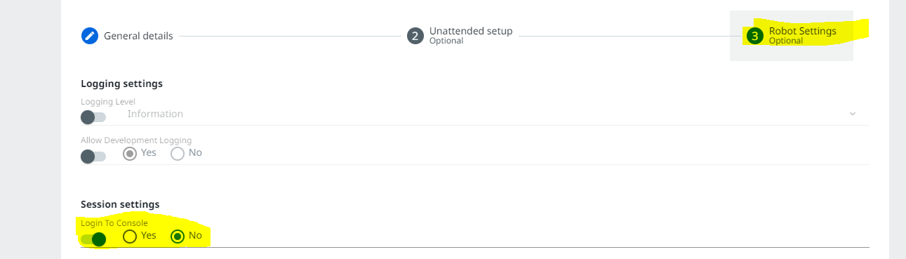

In user robot setting Set login to console like this
Also in unattended steup tab- Give only the domain\username (If you give full mail address it will not work) For correct username you can type whoami in cmd copy the ouput here.

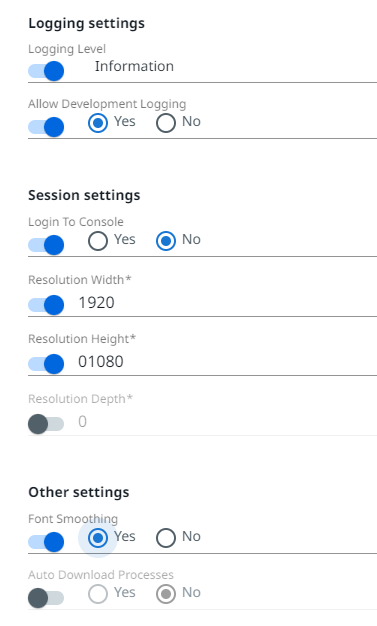

  3. I also adjusted the robot settings as shown in the photo below, following your suggestions."
