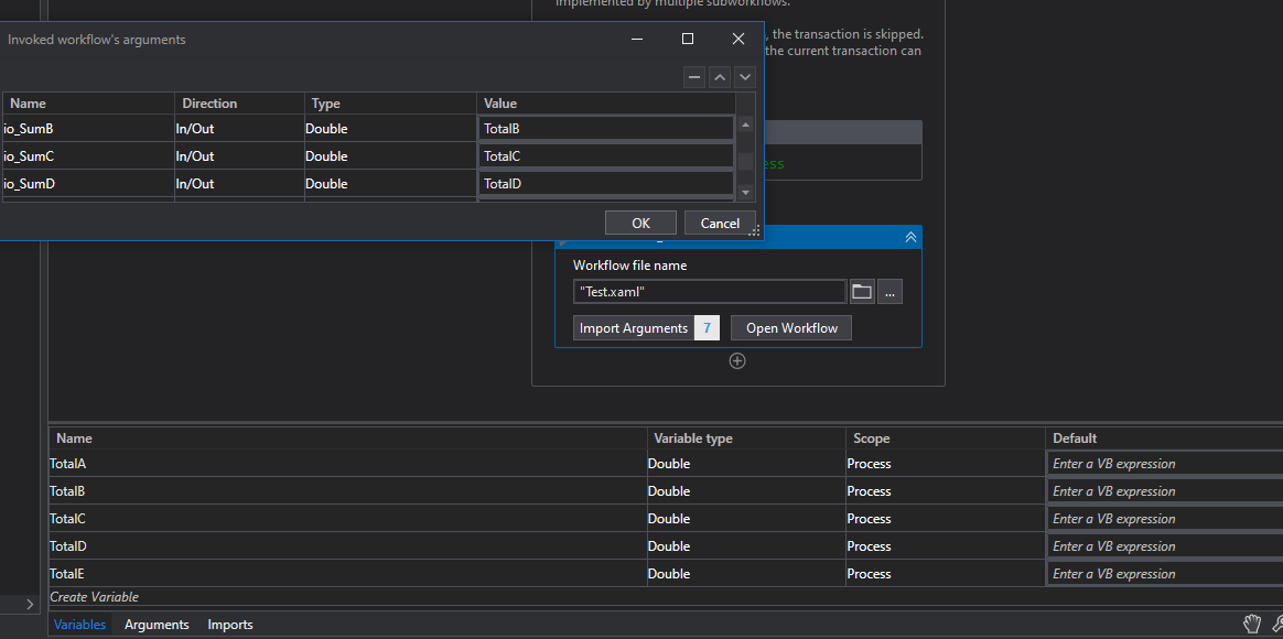

Hi guys, I’m having trouble storing values ​​inside the process.
I am working with a queue, it works well within the sequence, it gets the values ​​well to the invoke process, but when it removes another item from the queue it enters with the values ​​at 0. I have no default assignment.
I need to sum values, so I have to store the value.
I can’t solve it, since when it returns from get transaction data the argument is reset.
Thank you so much!
I work with reframework
@Adrian_Romero
You’re trying to sum up all the values returned from the queue items (one by one as it is returned)?
