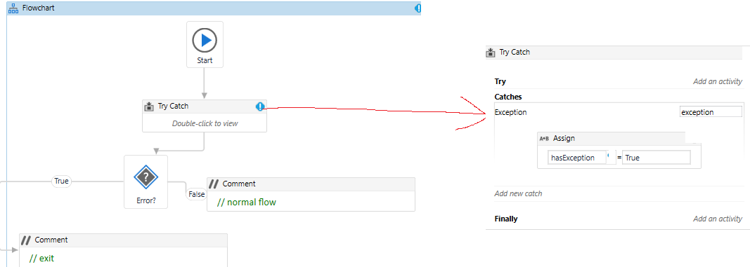

But what if I need to exit the chid workflow immediately upon incurring an error. Then what?
use flowchart
