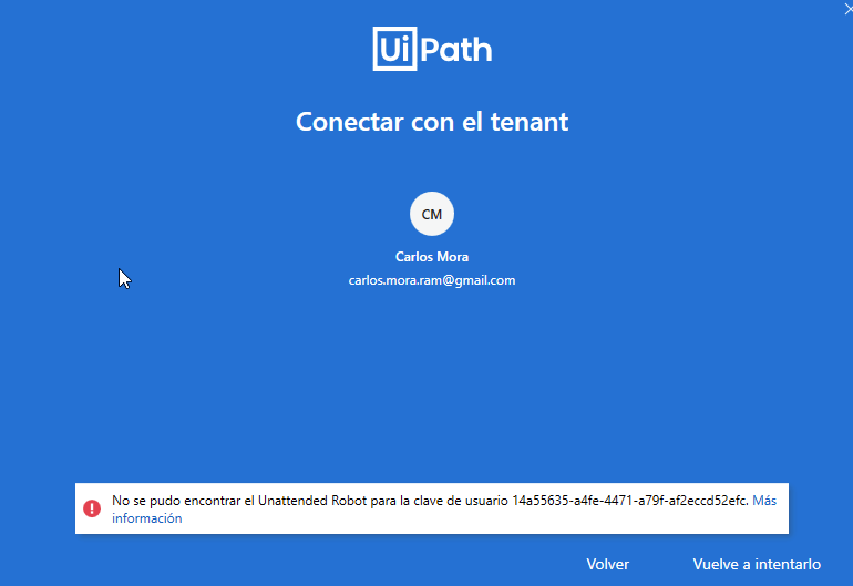

Hello, I am trying to publish a program with Studio and verify it with UiPath Assistant. The truth is, I am just starting, but in both UiPath Studio and UiPath Assistant, I get an error:
Communication error with the Robot service. Please check the status of the Robot service. Reason: unattended robot for the user key ------- could not be found.

@yedukondaluaregala thanks for your response. I followed the instructions you recommended, but now I can’t even log in.
. I’m really lost; there’s no information regarding the error.

Thank you very much, it was very helpful to understand the solution; however, what I had to do was the following:
  • Log in to cloud.uipath.com with my username
  • Go to admin → licenses → users
  • Under license allocations to users, click on allocate licenses:
    In names: enter the login email
    Select the option: Automation Developer - Named User
    Save.
Thank you for your help.
