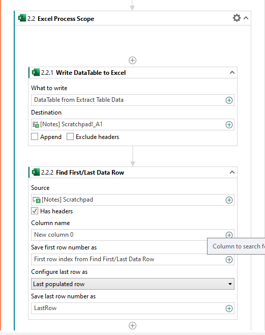

Use Table Extraction in the area where your attachments are and select Save For Later Use in to have a list of available attachments.
Then you can use Excel to write down the list of available attachment and to know on which position is last one using FindFirst/Last Data Row:

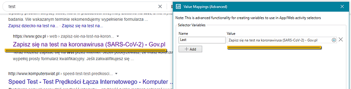

Now, in order to use a dynamic selector you should create a variable that will be used to select text of visible attachaments. The variable is used to validate selector.
in the Value field please type what actually visible on your screen, this will help to validate selector
The variabale should be assigned to actual last items from attachment list. in this example custom input of excel file is selected, cell addres is “A” next to it is the number stored under LastRow saved value.

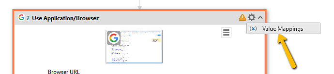

Next step is the click action. Indicate target on the screen that is aligned with variable name used in Value Mapping.
open settings, select Selector only, leave the aaname only, but instead of what was provided there please use double curly braces and put name of your variable inside.
this way only the last item from your list should be clicked and saved.
