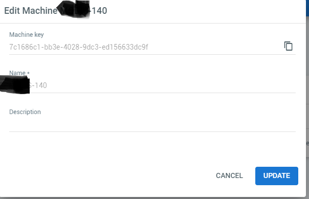

i’m just getting started with the Level 3 - advance training and REframework, i’ve tried to hook the robot to orchestrator but stil not working with this error: HRESULT: 0x8007052E username and password doesn’t work, i’ve just read a lot of similar post, but i can’t find the solution.
Username and password of pc are correct.
I’ve found the username trough cmd → whoami
If i open uipath robot it is connected,licensed
I’ve just delete all and rehook all again
What’s the problem?
Thanks in advice
can i have a view on the machine tab in orchestrator and the machine details in your robot tray of the machine where we want to run the process
and also the robot tab screenshot
Cheers @andreus91
print1 print3 print4
The machine name is the same

even i wonder why its not connecting…is the robot type is set either development or unattended…
if not change that in robot under ROBOT tab
–and apart from that if we are still facing the issue then delete the robot from robot tab and recreate it once again
check once with the password
Cheers @andreus91
Type studio is ok?
you mean the robot type
use DEVELOPMENT or UNATTENDED
@andreus91
print7
This is the type in orchestrator, can’t find development after the update, is that possible?
Thanks
Fine
choose this one
Cheers @andreus91
I’ll try but still also the same error message! :roll_eyes:
Thanks
kindly then check once with the password mentioned
@andreus91
or may be this could help you
Cheers @andreus91
everything is ok, the error must be where you set the machine user and password, make sure you are setting it as MACHINE_NAME\USER and not just USER…
