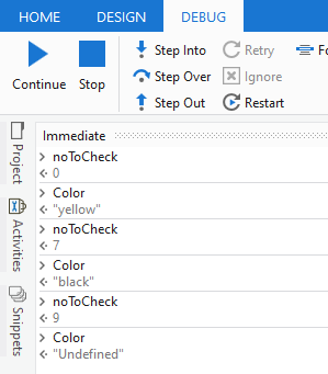

So we can get the color by number with following line
grafik
And will get:
grafik
