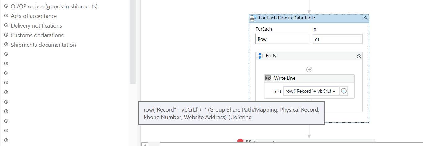

Actually, it comes back as \r\n but still get the same error when I use vbCrlf…cannot post the file because of security
Maybe there isn’t a space before the first (.
row("Record"+ vbCrLf + "(Group Share Path/Mapping, Physical Record, Phone Number, Website Address)").ToString()

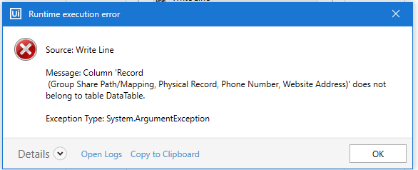

Still get this error:
tried the index by creating a variable index + 1 and then iterating through (0) and then (index) on two separate write lines. and I am not picking up the values…still get the same error

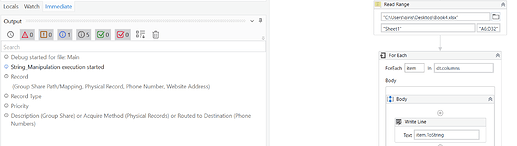

I think I found issue. When I printed the column header alone…i found there is an extra space before the (
You can see in the notepad file clearly…
Based on this i adjusted the code by adding space…I was able to print all the column values as shown below…
Hope this helps…
I already have the extra space in my code…not sure why I continue to get the error
Here is my current code
row.item(“Record” + vbLf + " (Group Share Path/Mapping, Physical Record, Phone Number, Website Address)").ToString
