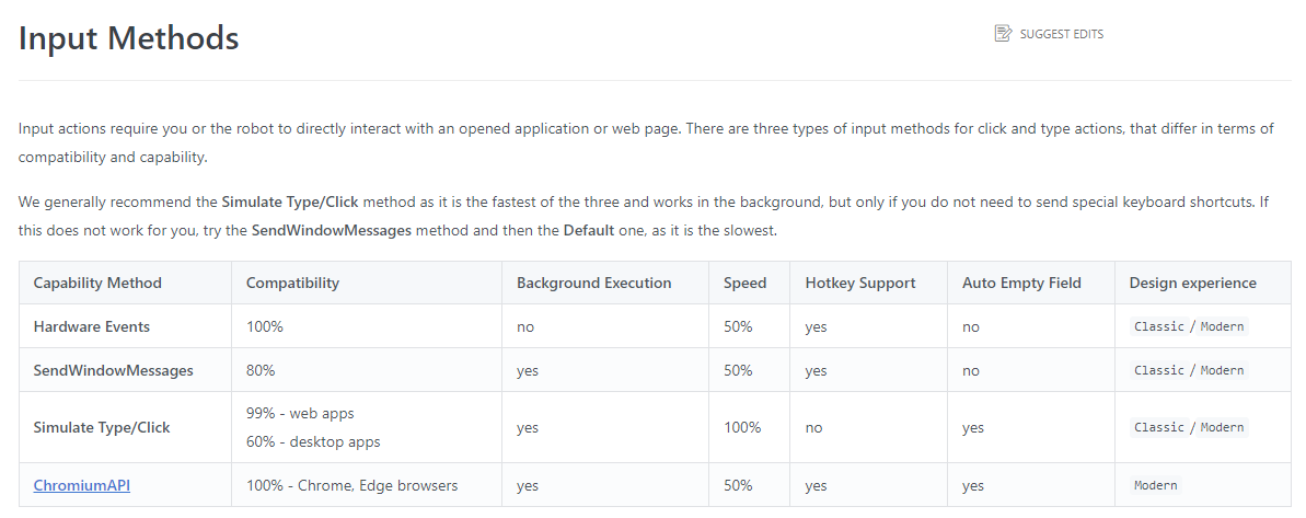

Change the Input method type as the Hardware events is not compatible with Background execution.
Reference: Input Methods

@Lakshmi_Holla Yes like @marian.platonov said please change the input mode as simulate and try again once

oh but then how do I automate that desktop application? Simulate,window message does not work.
Should it be done with UiPath.Core.Activties ->Image and hot keys?
With hotkeys, you will be able only with SendWindowMessages for desktop apps.

Wanted to let everyone know that this was solved by using Send Hot Keys for all the clicks/typing/navigation.
