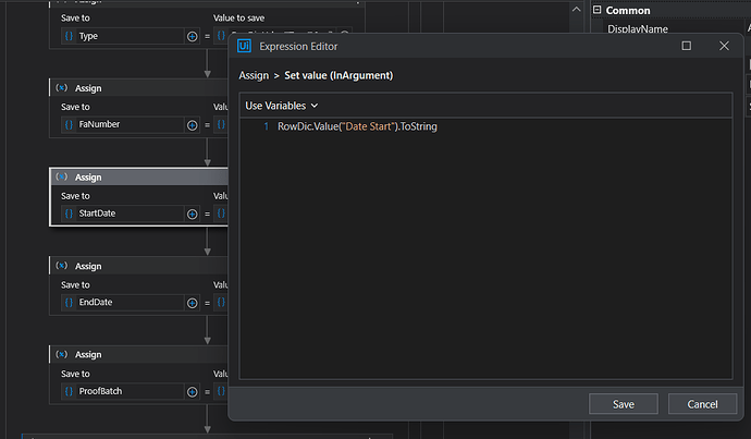

Thank you so much, but if I want to write cell Start Day and End day (Column M and N) as well as Proof batch (Column S) from input file to start day and end day (column B and C) as well as Proof batch (column I) from output file in the merge and merge format.
How I can edit?

I am writing the robot in this way, but it can’t fulfill my target.
Can anyone help me to edit?
Many thanks
