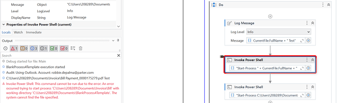

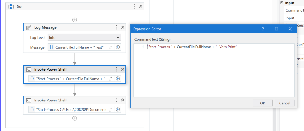

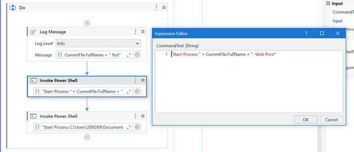

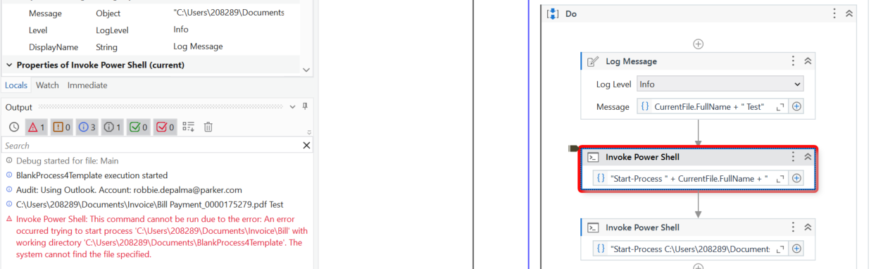

I decided I want to go with the Invoke powershell method to print.Below is what I have but the file name doesn’t seem to be passing all the way through.
Here is the error I get
