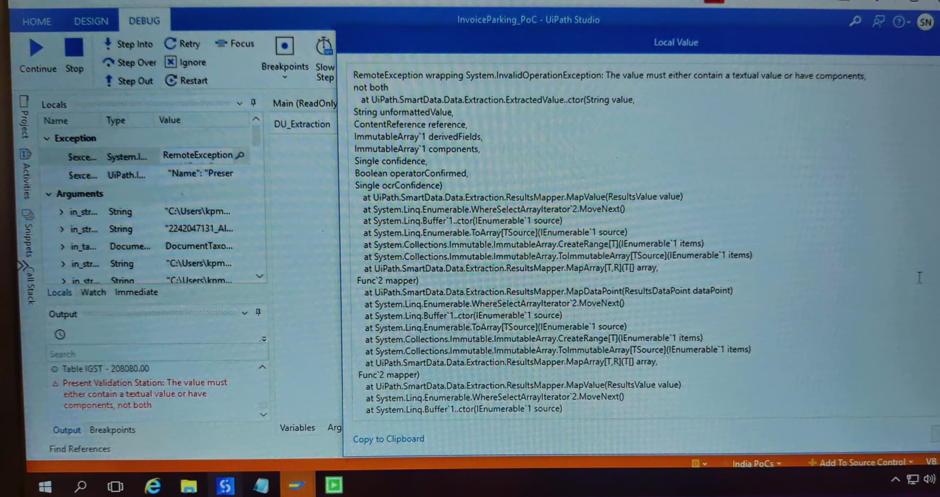

Can you run in debug and open locals panel and check the exception details from there?..you would have little detailed explanation in that exception

Here is the screenshot of the exception from Locals
