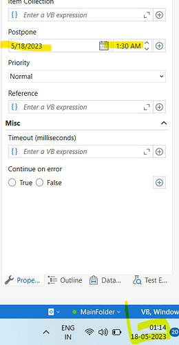

I have tried to add some queue item with a minute or 2 min postpone time. But whenever the queue item is available in the queue with NEW state the process is getting triggered immediately.
It’s not waiting for the postpone time to be over of the queue item.
@Biplob_das
Can you please check the postponed time that you have given…orchestrator generally takes utc time…because of time difference may be the time given is behind…try adding a day and check …so that we cna be sure or tey using date convertion yo utc
Yes sure I can check that but then the normal time trigger is getting working correctly. If it’s about date conversion then the normal trigger would not worked also.
The time is getting added correctly I think…
For example the screen shot that I provided.

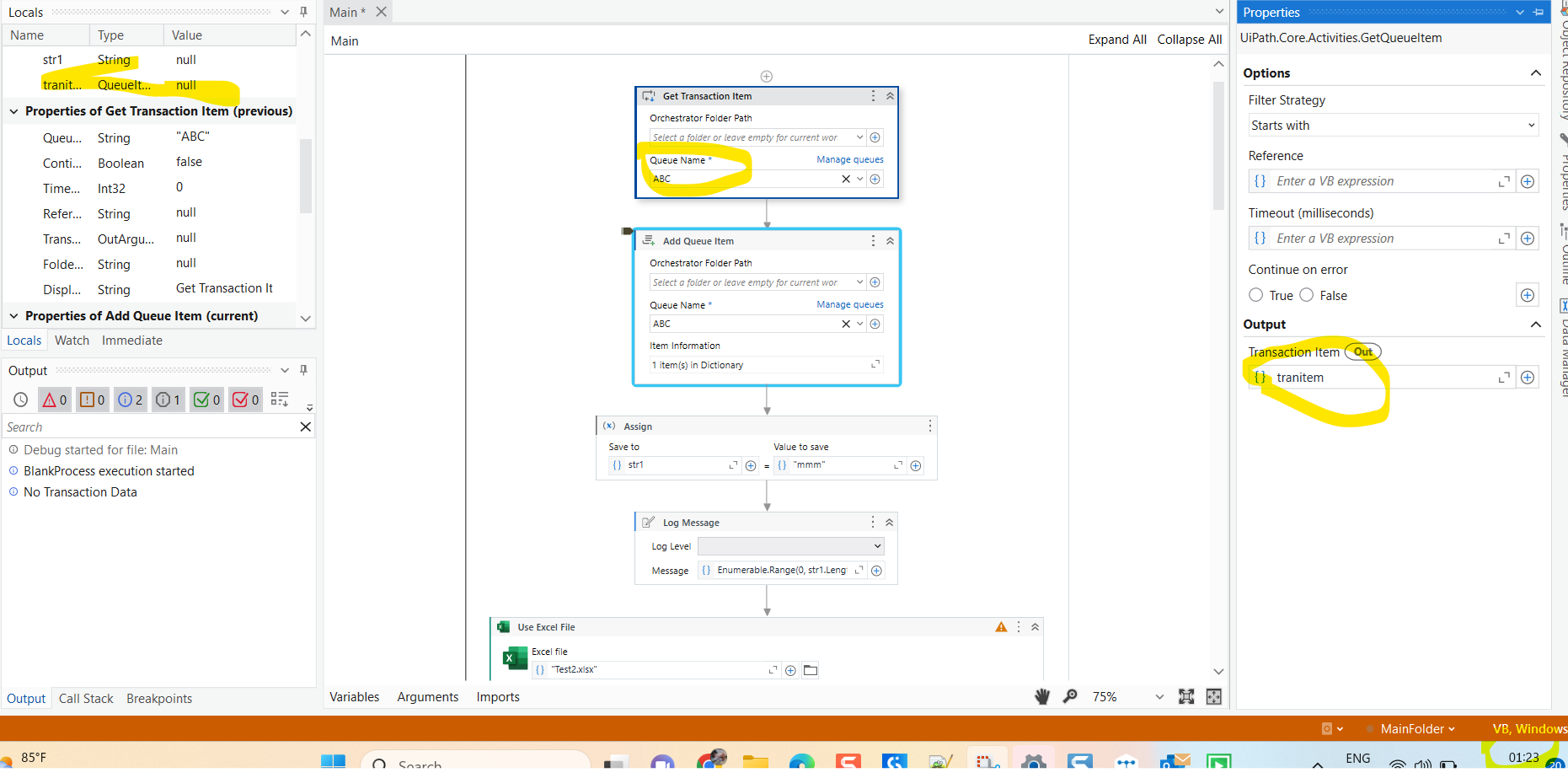

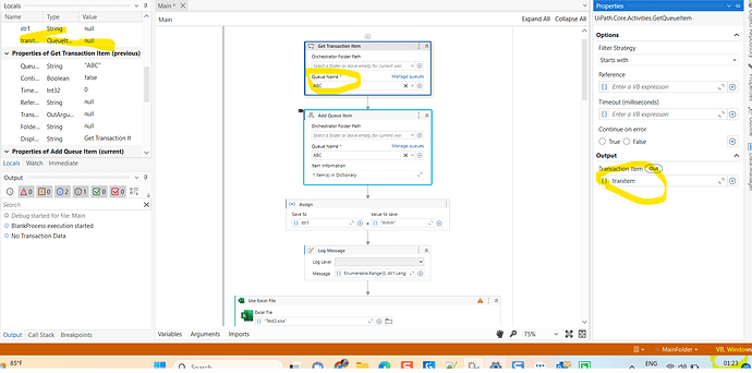

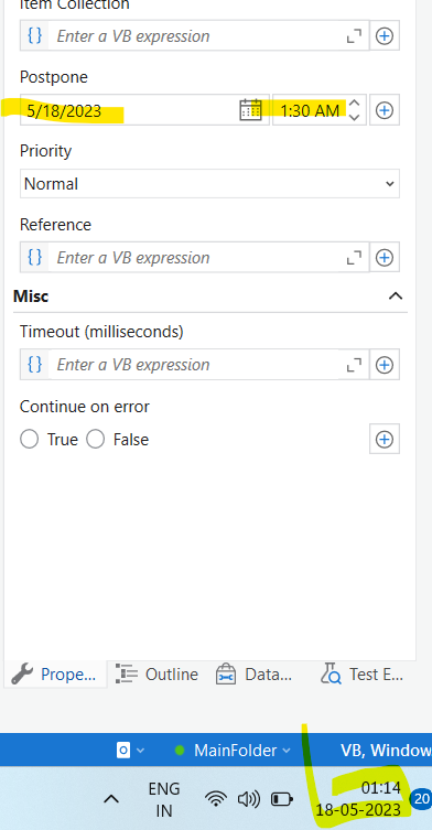

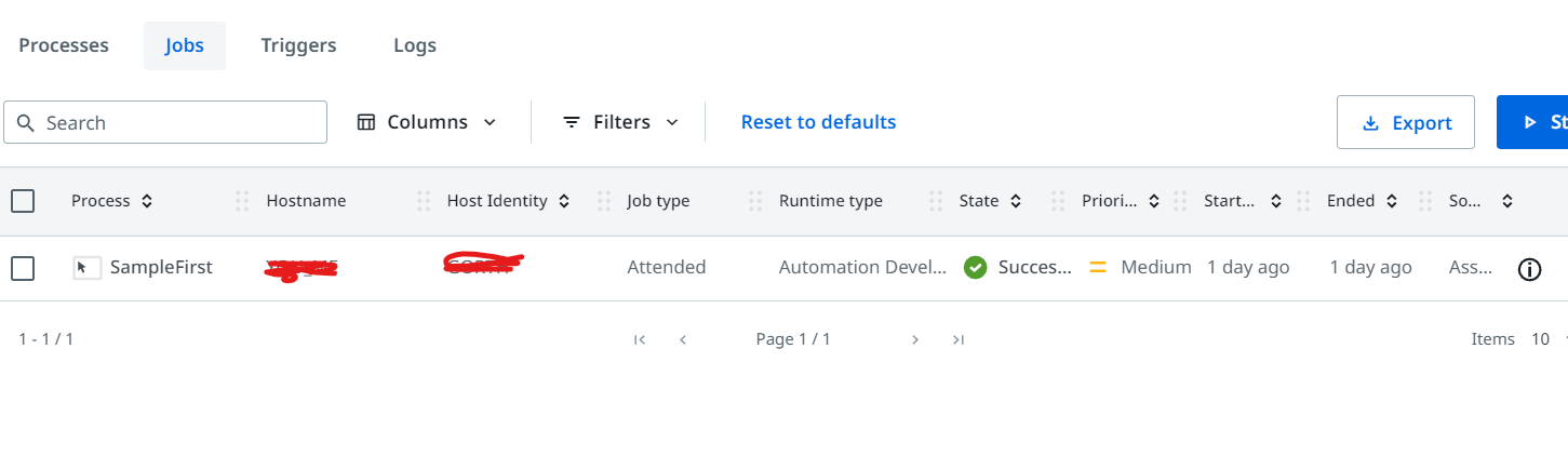

Few pointer here…I added a queue item just now like this

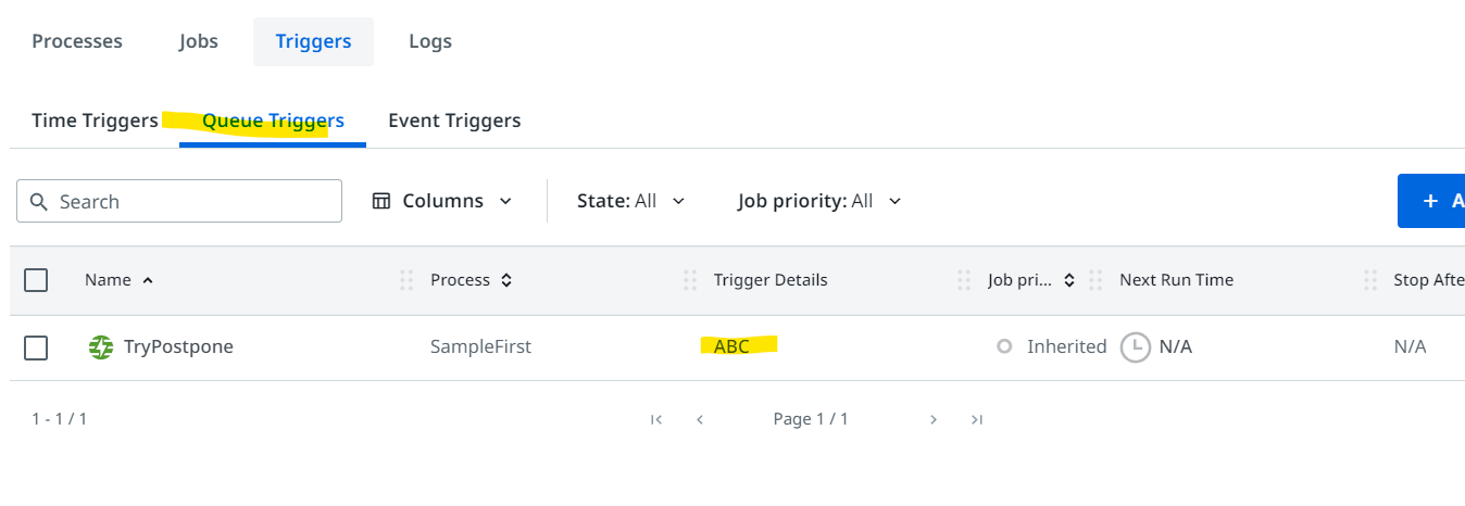

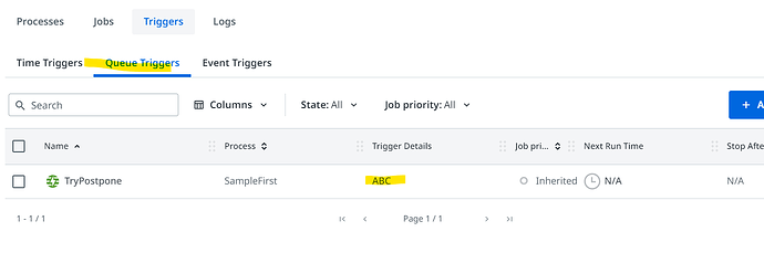

orchetsrator…A queue trigger is setup already
Trigger
The job did not trigger yet

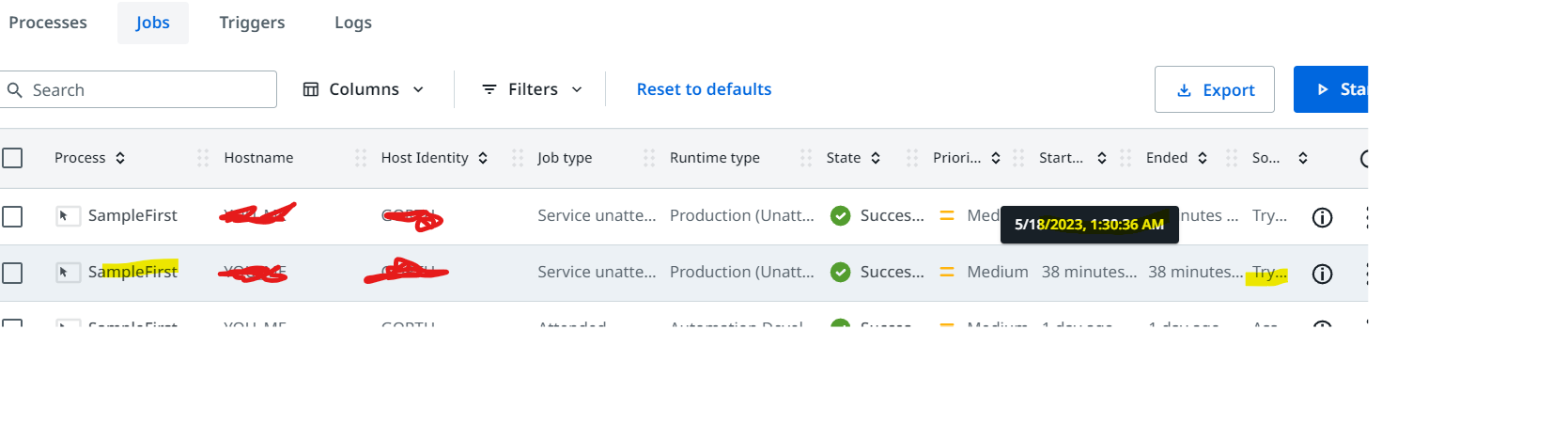

Tried get transaction item not getting item as time should be 1:30 …and here it is 1:23

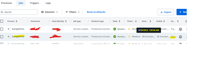

Auto triggered after 1:30
Mine is cloud orchestrator cannot change trigger time for queue
