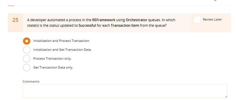

I have taken practice test for UiPath certification. In that I have a doubt in reframe work question.Can you please confirm with the answers below as my review results says, below answers are wrong. thanks.

Hi @Nancy29
25th question answer -
Option 4 - Process Transaction only.
Explanation - In this question they asked about in which State the Transaction item of queue is updated to success. In Process Transaction state only the transaction item status updates.
33rd question answer -
Option 1 - Set TransactionStatus.xaml
Explanation -
In the above question they asked about in which state but here it asked about in which workflow,
Then the answer is Set Transaction status is the workflow where the queue item got status update and the Set Transaction status workflow is in the Process Transaction state.
Hope it helps!!
