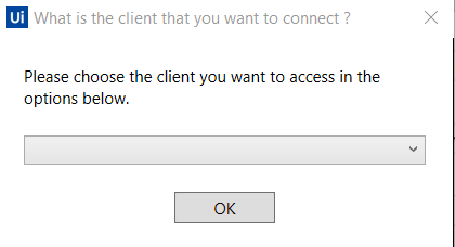

Hi @Luis261980
You can use the custom input activity.
This will helps to include the html part which helps to include the images too
check the documentation of custom input activity
Well i had built something simmilar to ur requirment using the above activity and finally dialog box look like this
Hope this helps you
