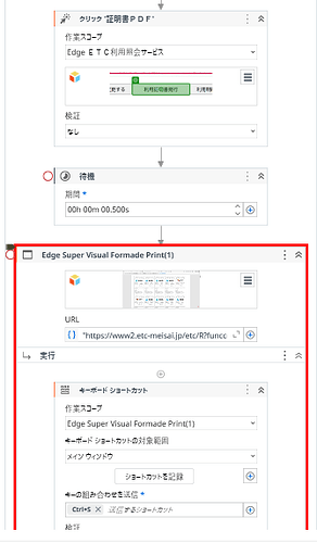

Acquiring PDF / Steps to save PDF after opening the viewer in a new page
① Click “Certificate PDF”
② Wait 2 seconds
③ Click “Save Icon”
④ Wait 2 seconds
⑤ Keyboard shortcut [k(enter)]
However, it stops at step ② “Save Icon.”
Do you have any missing activities?
It’s not that there are not enough activities, but perhaps the properties setting for the input mode and open/close of the browser surrounding the activity that clicks the save icon is incorrect?
The recommended settings for open/close are both Never or None.
The input mode should be:
Background
Simulate
Window Message
Try them in order and see if you can click.
What is the current status? If there is an error message, it would be helpful to share that.
Thank you.
  1. Click the certificate PDF on the site.
  2. A PDF viewer will open in a new tab.
  3. Click save (ctrl+s).
  4. Enter is the shortcut key.
  5. Move the file.

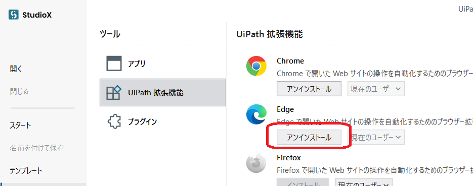

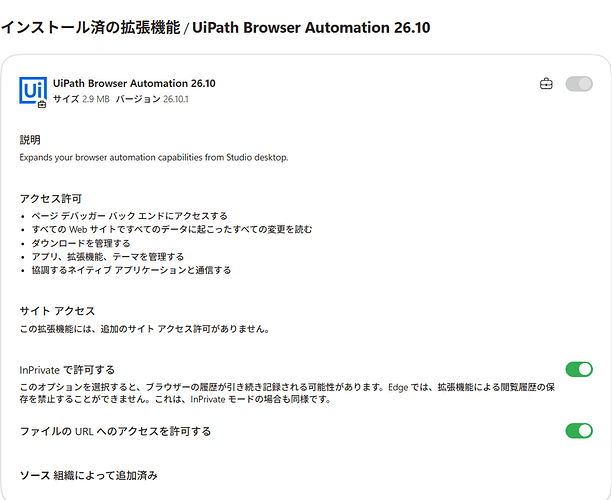

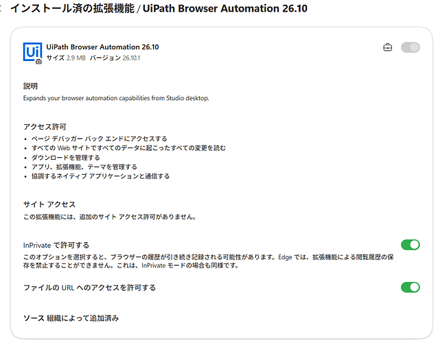

  1. Error message: Edge Super Visual Formade Print(1): ‘msedge.exe’ could not communicate with the UiPath extension for the browser. Please ensure that the extension is installed and enabled.
Best regards.
Is the UiPath extension for Edge browser disabled? Please refer to the attached image and try uninstalling and reinstalling the UiPath extension.

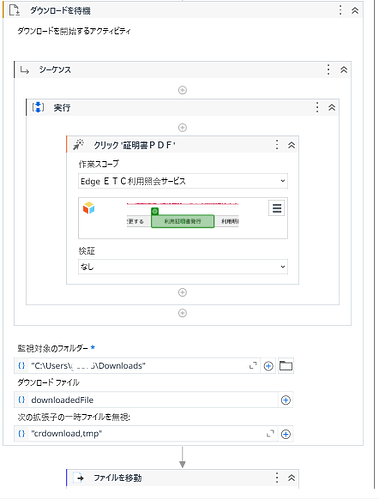

Have you started using SVF Print in the PDF viewing settings of Edge? Alternatively, if you can change the settings to allow downloads, it might be more reliable to do that and then use the download wait activity.
Thank you very much. I installed it again.
It might be an issue on the browser side.
Thank you. I have changed the settings in Edge to allow downloads.
I will change it to a download wait activity.
(This may happen tomorrow.)
Thank you for your support.
I set the download settings and configured the download waiting activity, but it seems to not be working.
The download has not taken place.

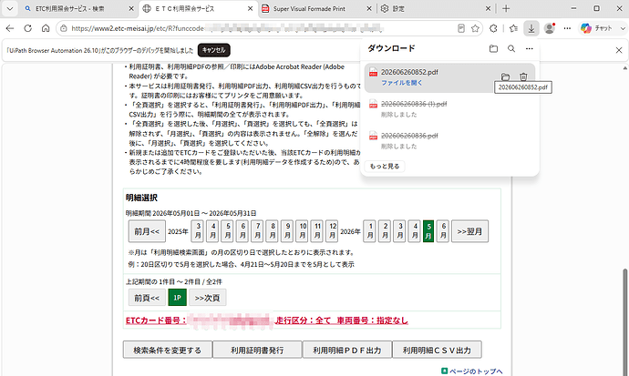

What does it look like on the screen?
If the content of the PDF is displayed, then it means the download hasn’t completed.
If the download has completed, it should appear in the notification area in the top right (or in the download icon).
Although I can download and move the csv files,
I wasn’t able to download the pdf files either.

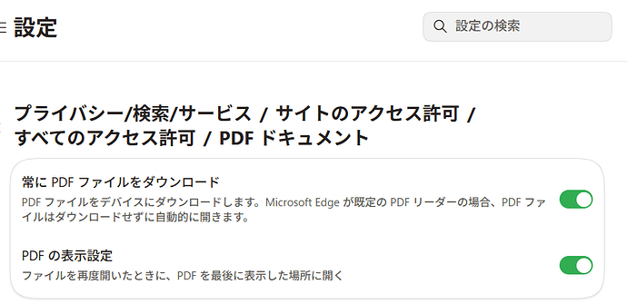

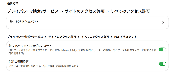

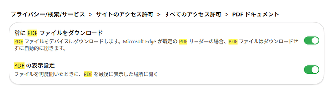

First, there is a mention of SVF Print, which seems to be a server-side mechanism, and the resulting PDF was quite standard. Therefore, by enabling the “Always download PDFs” setting in Edge, it resulted in a file download; if this setting is disabled, the PDF is displayed inline.
Thus, if this setting is available, using the download wait activity would be the easiest option.
For example, there’s a link to a PDF file on the following page, but does this setting toggle between inline display and download?

I had set it up already.
The dialog also appears.
However, I am unable to download, and SVF Print opens instead.
It might be due to insufficient permissions for the extension.
First of all, is it possible to download even when you operate manually?
If it can be done manually, there may be an issue on the UiPath side, but if it cannot, then I think it might be a problem with the Chrome or OS settings.
Also, it seems that the extension is not enabled, and if that’s the case, it also appears that operations like button clicks cannot be performed automatically. Is that working? Or is it being recognized through Computer Vision?
If there is an issue with the extension, please refer to the following (although I don’t think this is the direct cause of the download issue):

The extension is locked and cannot be allowed.
Therefore, I also cannot perform the button click automatically.

If it’s for use within a company, it might be in a state where it’s restricted by some policy. It could be a good idea to consult the IT department if possible. Even if direct downloads through the browser are not possible, there may be a chance to do it through UI operations.
