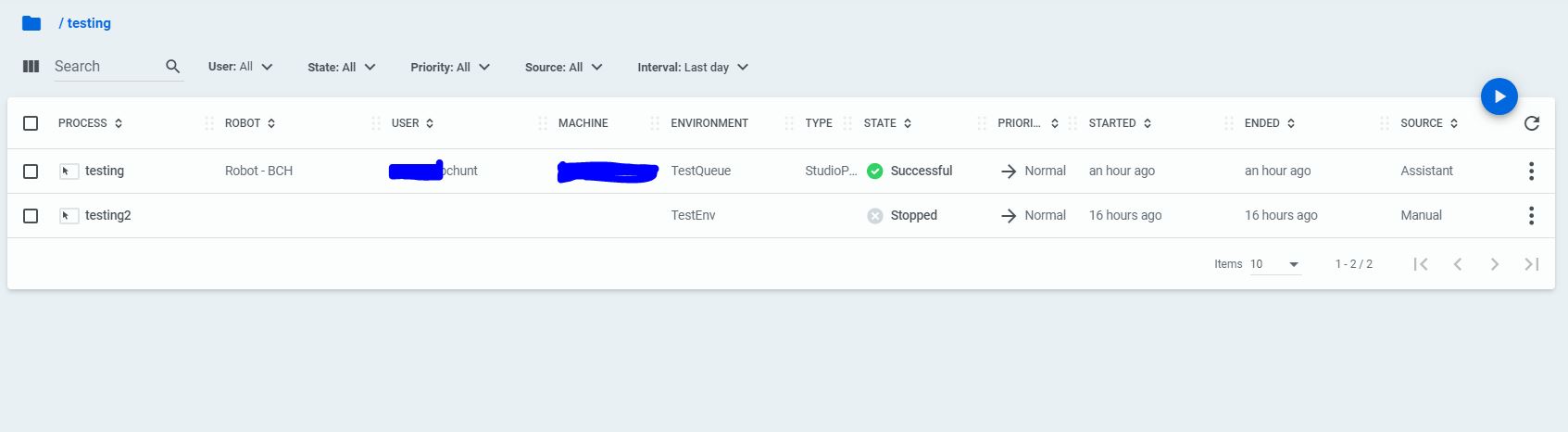

I tried following your steps, but am not having success. Here are some screen shots.
I get the error simply by going to Monitoring-> Jobs, selecting the testing2 job and “restart”. I can’t delete it. I can delete the processes. Is that how it is supposed to work? I was thinking jobs would disappear once run…?
Finally, when I try to build a new process instead, I don’t see my robot. This is true is I use either of my two environments. The robot seems to be in both. So I would think either one would work.
Ok. Skip the job restarting.
Change the type of your robot to Unattended (it is now set to studioPro). Then when you start a new job you should see your robot appear. When you have set it to studioPro you probably won’t see it when you create a job.
K Thanks. That did it. Is there a way to have both an unattended robot and Studio license available on this laptop? If I go to unattended, it breaks my Studio Community edition which goes into a read only state. Or is the process for the Community edition switch to unattended, build a job, and then finally switch back to Pro?
