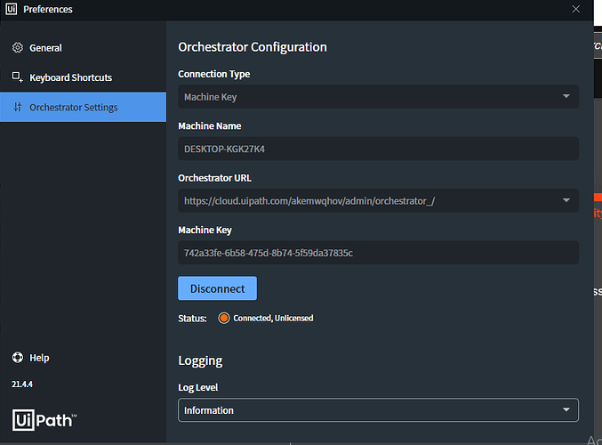

3. i tried to connect uipath assistant through machine key but it was showing orange and un licensed.

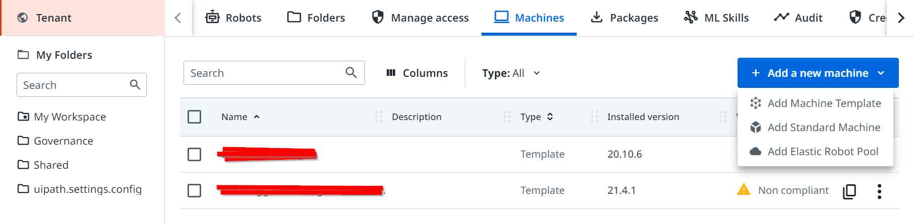

Community version in your screenshot has modern folders enabled. So process to create robots is lil different when it comes to modern folders.
To create standard machine here, please navigate to tenant->machines instead of robots(robots page will only show the list of robots created but wont allow any creation). So under machines, you will be able to see all options to create standard machine or template as shown below:

And your 3rd query,
Once you create a machine by following above steps, and assign non-production license(for unattended purposes in non-prod env), you should be able to connect.

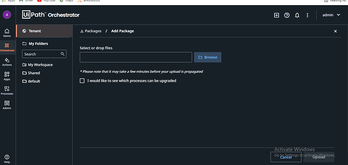

my package at tenant level but on upload tab its forwarding to upload from folders

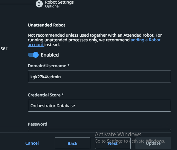

and this is what showing while adding new process.
so finally i need to know how to deploy package at folder level from tenant level.

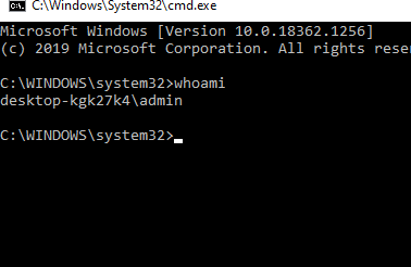

Can you please go to your command prompt on the machine you are trying to run the unattended process on, type “whoami”, and paste that domain\username for the unattended bot in the user settings as seen here and enter the windows password under “password”:
This screen you would under tenant->Manage Access->selecting your username-> clicking on edit.

i put there same
Hi @ankur_kaushik2,
Its different…
Right one is desktop-kgk27k4\admin
You need to put exactly the same shown in command prompt.
Regards
Sonali
ohh i must involve destop too.thanks lemme check :sweat_smile:
i just restarted and it worked with same name,thanks for all that help. :slightly_smiling_face:
