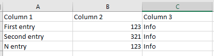

Here’s my kind of input file. I am going to upload each line to the Orchestrator first. Then I want to send only one email to the recipient who has 123 code, and the second email will be sent to the 321 code. The tricky part actually is that I never know values in column 2, so I can’t build a dictionary, can I?
Screen Shot 2021-10-22 at 9.31.53 AM
that’s fine
we are referencing the data, that can be anything…
Whatever the data is, just send the reference for the part you want to group, ie., in your case Column 2 data and in collection, mention the remaining data
give a try to above skeleton. that’ll work
