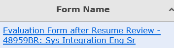

yes it worked. Another problem I am running into is that when I want to copy the text it is either a hyperlink or regular text. I want to copy the first instance the text appears and paste it into excel. Here’s how it looks:
hyperlink%20kenexa regular%20text%20kenexa
The wildcard* selector doesn’t work because it would only recognize the hyperlink and I’ve tried other get text methods, so I am stuck for the moment.
Try with screen scrapping method in the design tab of studio
That would work for sure
— scrape the region and it will get all the txt in that region been selected
