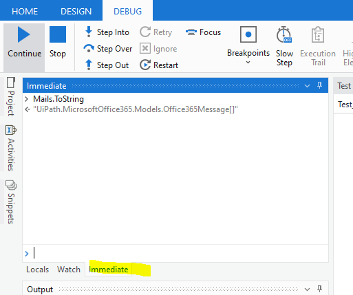

we would recommend to do such analysis on immediate panel
set breakpoint
run debug - get paused
open immediate panel
check statements
grafik
this way of exploration is faster and more direct
Also check your statements and respect case sensitive var names
Mail (for each) vs. mail… from other screenshot
