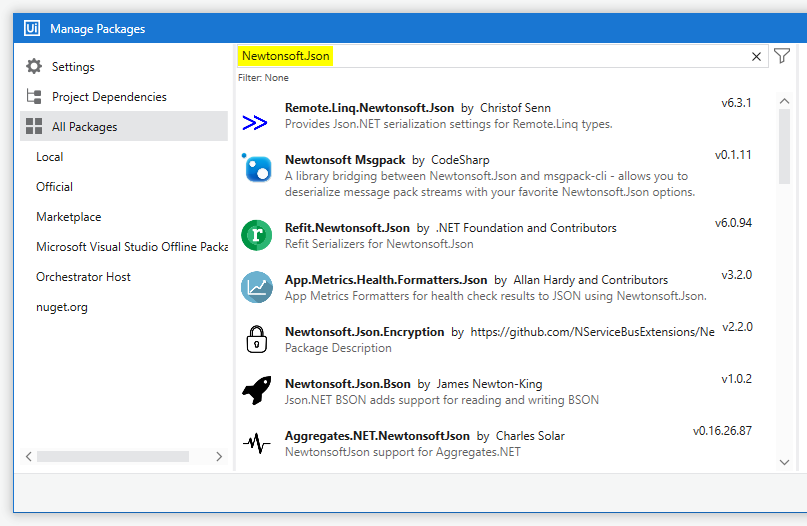

Here are the results from my first search.
I cleared the search box and typed in Newtonsoft.Json again. 5 of the 7 results changed. The order of the 2 results that were the same also changed. Newtonsoft.Json didn’t appear in the results at all.
