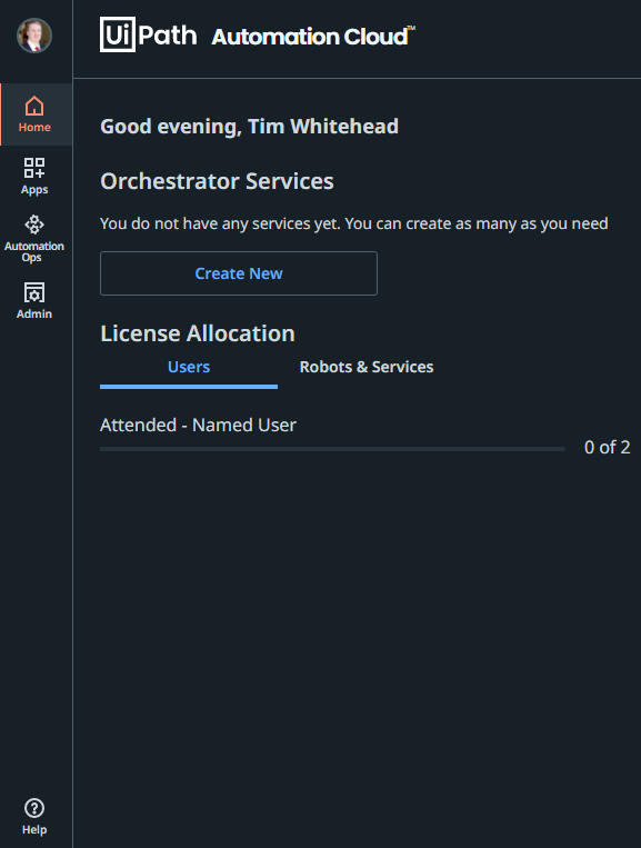

Can you please elaborate on what you mean by “Service under Orchestrator” as well as what you expect to see?
Community edition only allows for a single Tenant / Orchestrator Service as such when you click the Orchestrator Tab it will open the only instance available.
If your view looks more like the following, you need to create your first Tenant / Orchestrator Service via Admin > Tenants > Add Tenant.
