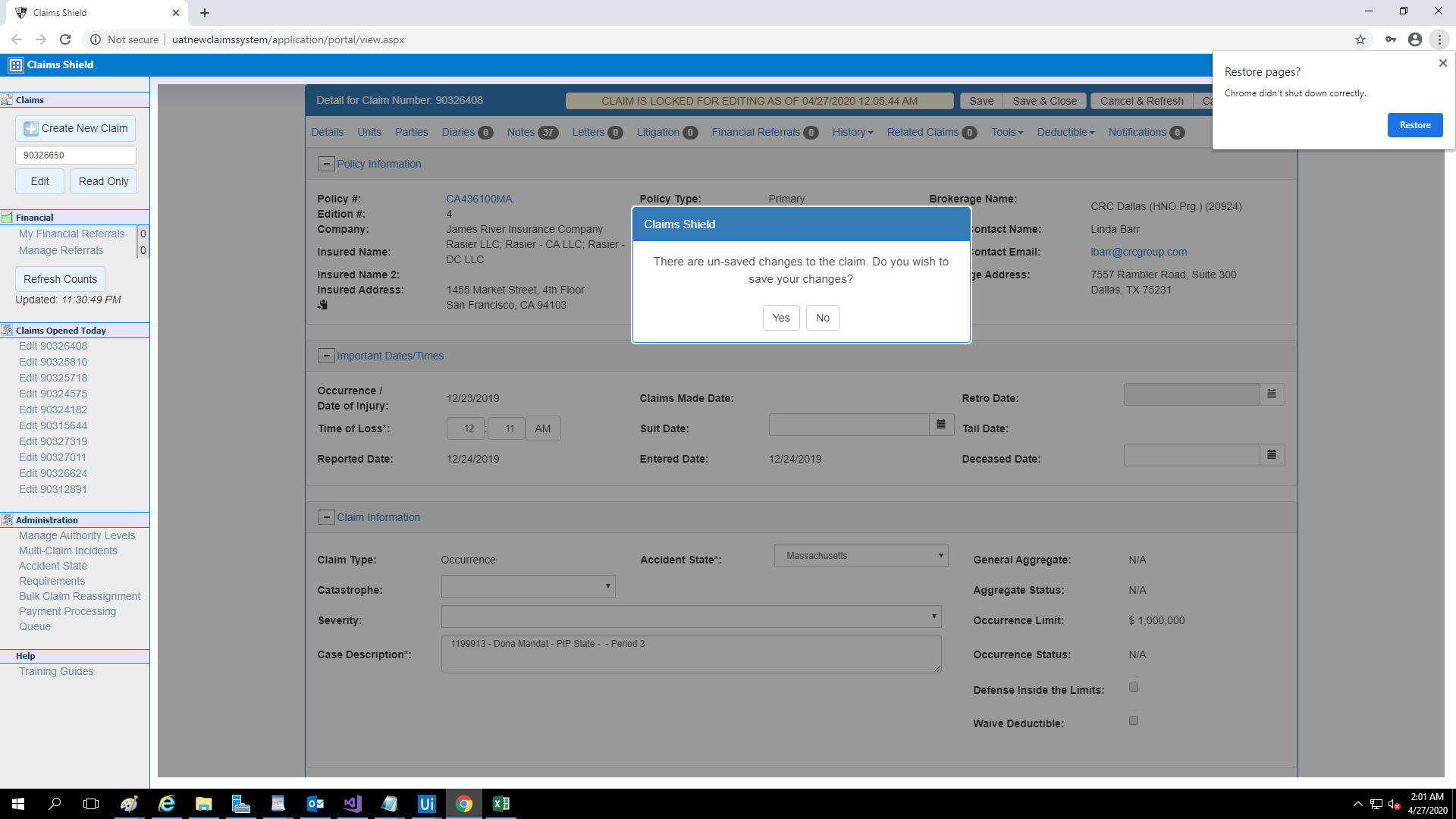

Hi,Click on yes button not working.As mention in attachment.
Try Attach Window : Attach the Claim Shield Popup Window. Inside this - Try Clicking on Yes.
You can also look for and Hotkey alternative (such as Tab + Enter) or nay other that you are able to click on Yes without using Mouse.
β
Mukesh
What about Attach Window -
Are you able to attach the new Window ?
yes but when I try to capture that popup.But Attached window select full screen.
So when the Popup is appearing on screen - Is there any way to select Yes apart from the Mouse Click ?
No I donβt think.As mention in attachment there is two button with name yes and no.
Okay , Then Image Automation will be the Last resort here in that case β¦
Also , Have you tried using other browser apart from Chrome ?
