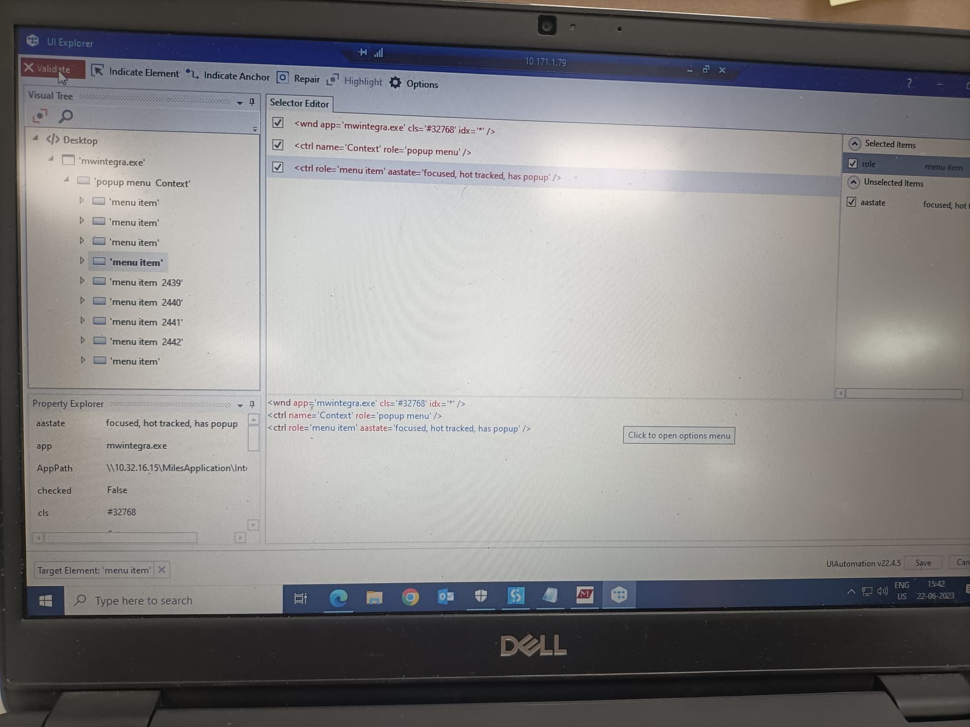

Hello,
I am working on application soi want to click the tools then process but I’m not able to use click I can’t change the selector how the click will work

Hello,

In your second screenshot, idx=‘4’ in selector correctly refer to the process (4th item in list). You can try same thing for “Day End Process”. Just keep 2-3 seconds delay between the click activities.
