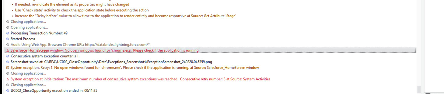

I am constantly getting error as No open windows found for ‘chrome.exe’. Please check if the application is running after 300 Transaction Item due to which my selectors are failing. Till 200-300 this error is not there , once the bot runs for longer duration, its throwing error as “No open windows found for ‘chrome.exe’. Please check if the application is running.”

I am getting this error for 49 transaction also. I think some issue with chrome installation ?
