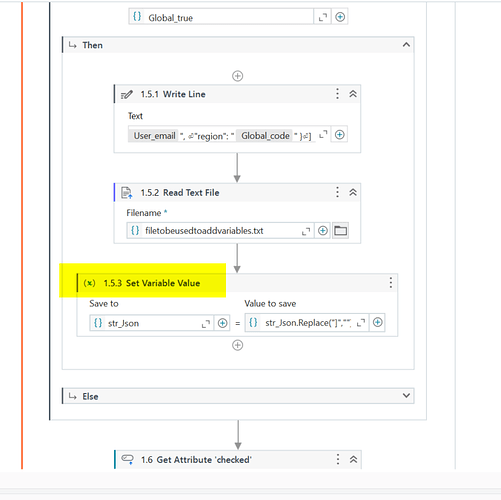

HI @andrea.venturino
As you are using StudioX i have created a workflow in StudioX only please check below:
Regards

Hi @andrea.venturino
If you want to write the data back to text file then please write the data to a new text file by using the Write Text activity. Please note that the modified data need to be written in a new text file.
If you wanted to write back to the same file the use the below workflow:
For writing to the same text file you need to delete the file because the write text file will helps in overwritting the data so whatever the excess data is there in file it will remained same so before using the write text file make sure that you have deleted the existing text file.
Regards
