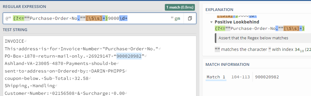

Hi @manojmanu.rpa ,
Maybe you can try using the below regex :
(?<=""Purchase Order No.""[\S\s]+)9000\d+
Expression :
Regex.Match(yourInputStrVar,"(?<=""Purchase Order No.""[\S\s]+)9000\d+").Value.Trim
Also, do confirm if the Purchase Order No. will always start from 9000.

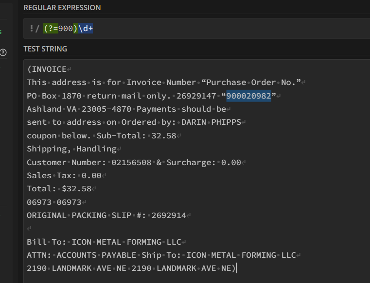

Hello @manojmanu.rpa
Try Regex Expression
System.text.regularexpressions.regex.match(YourStr,"(?=900)\d+").tostring.trim

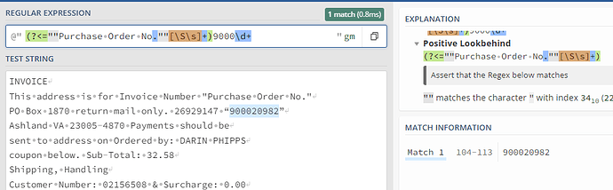

Hi @manojmanu.rpa
Option 1:
Updating the pattern from @supermanPunch - you can use the below to match exactly 9 numbers in a row with no reliance on “900”. Regex Preview link
System.Text.RegularExpressions.Regex.Match(yourInputStrVar,“(?<=Purchase Order No.[\S\s]+)\d{9}”).Value.Trim
Option 2:
I have a second pattern which might suit your needs.
The pattern relies on:
  • If the purchase order number is always 9 digits long then this will work Including the ‘900’
  • Has only 0 or 1 non-digits at the end.
Regex Pattern - Preview the pattern here
System.Text.RegularExpressions.Regex.Match(yourInputStrVar,“\d{9}(?=\D?[\r\n])”).Value.Trim
Option 3:
  • Matching any number of digits which appear at then of a line.
System.Text.RegularExpressions.Regex.Match(yourInputStrVar,“\d+(?=\D?[\r\n])”).Value.Trim
Hopefully this helps :blush:
