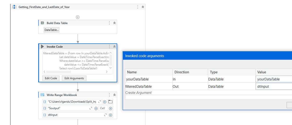

@sruthesanju
filteredDataTable = (From row In yourDataTable.AsEnumerable()
                     Let dateValue = DateTime.ParseExact(row("Date").ToString(), "MM/dd/yyyy", CultureInfo.InvariantCulture)
                     Where dateValue >= DateTime.ParseExact("03/01/2022", "MM/dd/yyyy", CultureInfo.InvariantCulture) AndAlso
                           dateValue <= DateTime.ParseExact("03/31/2022", "MM/dd/yyyy", CultureInfo.InvariantCulture)
                     Select row).CopyToDataTable()

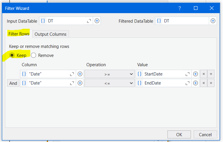

Hi @sruthesanju
Can you try the below
StartDate=DateTime.ParseExact("03/01/2022", "MM/dd/yyyy", System.Globalization.CultureInfo.InvariantCulture)
EndDate=DateTime.ParseExact("03/31/2022", "MM/dd/yyyy", System.Globalization.CultureInfo.InvariantCulture)
Input:
Output:
