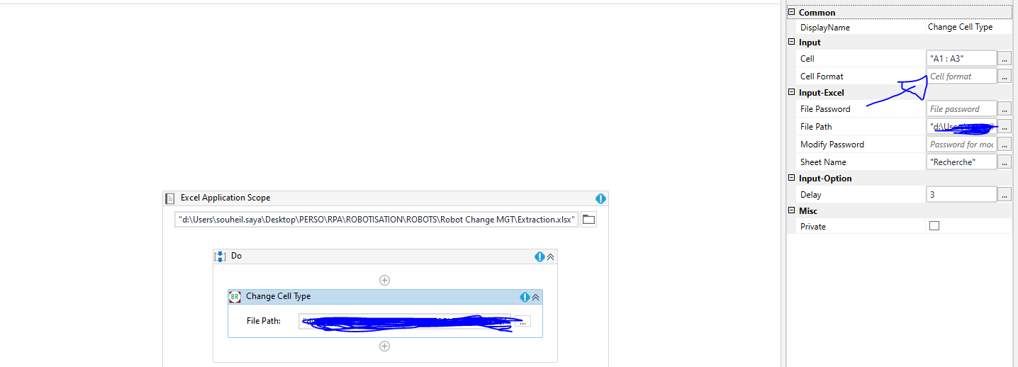

Need to change the format of cells in EXCEL plz
Hai @Soudios… Use Change Cell Type Activity that will available in UiPath version 2019.4.0
@Soudios… Feed ur inputs properly ,provide cell range within quotes that u want to change , provide cell format … & Path of the Excel file
i think i have all oh that, but i don’t know what is the sentence to change a cell
