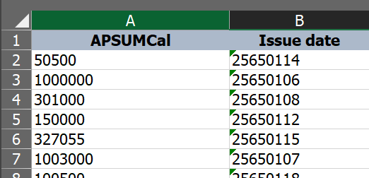

Need help to edit code LINQ?
Now I use code as below.
InputDT.AsEnumerable.Where(Function(x)x(“สถานะ”).ToString.ToLower.Equals(“นำจ่ายสำเร็จ”)  And CInt(x(“จำนวนวัน”).Tostring) >= 15 And x(“APSTS1”).ToString <> "FLFL" And DateTime.ParseExact(x(“Issue Date”).ToString.Trim,“yyyyMMdd”,System.Globalization.CultureInfo.InvariantCulture).AddYears(-543)<= ApproveDate AndAlso String.IsNullOrWhiteSpace(x(“Status”).ToString) And String.IsNullOrEmpty(x(“Chk Dup”).ToString.Trim) And String.IsNullOrEmpty(x(“Lot Sent”).ToString.Trim)).ToArray
I want add condition as below.
I have variable DateReceived as string =18/1/2022
I want to filter excel column Issue date that <= DateReceived
*Remark : Format in column Issue date as yyyymmdd (yyyy = month in Buddhist calendar )
Please guide me for edit code LINQ.
ref.xlsx (8.9 KB)
input6.xlsx (58.2 KB)

@Nithinkrishna Sorry I use column วันที่รับเล่ม
Not Approve Date
ref.xlsx (8.9 KB)

@Nithinkrishna If I want change from column Issue Date to column วันรับเล่ม as below.
If file excel column วันรับเล่ม as format text
How to edit code from below?
DateTime.ParseExact(x(“Issue Date”).ToString, “yyyyMMdd”, System.Globalization.CultureInfo.InvariantCulture)
