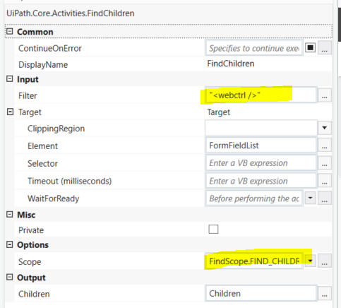

About the find children:
grafik
In general we do set a filter when using the find children activity:
e.g. <webctrl tag='label' /> getting all label elements
Depending on the HTML structure we also modify the Find Scope e.g to FIND_DESCENDANTS when the elements are not direct children
