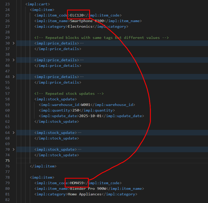

It seem warehouse_id exists in different item element which supplier_id element exists in. This mean there is possibility to be different number of element of warehouse_id and supplier_id because there is no relation from view point of item_code.
So my question is “Is it related between warehouse_id and supplier_id and does it’s assured that number of element of warehouse_id and supplier_id is always same?”
If the above is no problem, can you try the following sample?
Sample
Sample20251028-1.zip (11.6 KB)
Hi @Kunal_Jain28598 ,
As @Yoichi already pointed out, you have 2 different items; it isn’t possible to grab warehouse id from one item and supplier id from the other into the same row of a table.
I’m guessing the sample xml file that you’ve uploaded is totally different to the data you want to work with. You probably need to rethink how you want to proceed.
