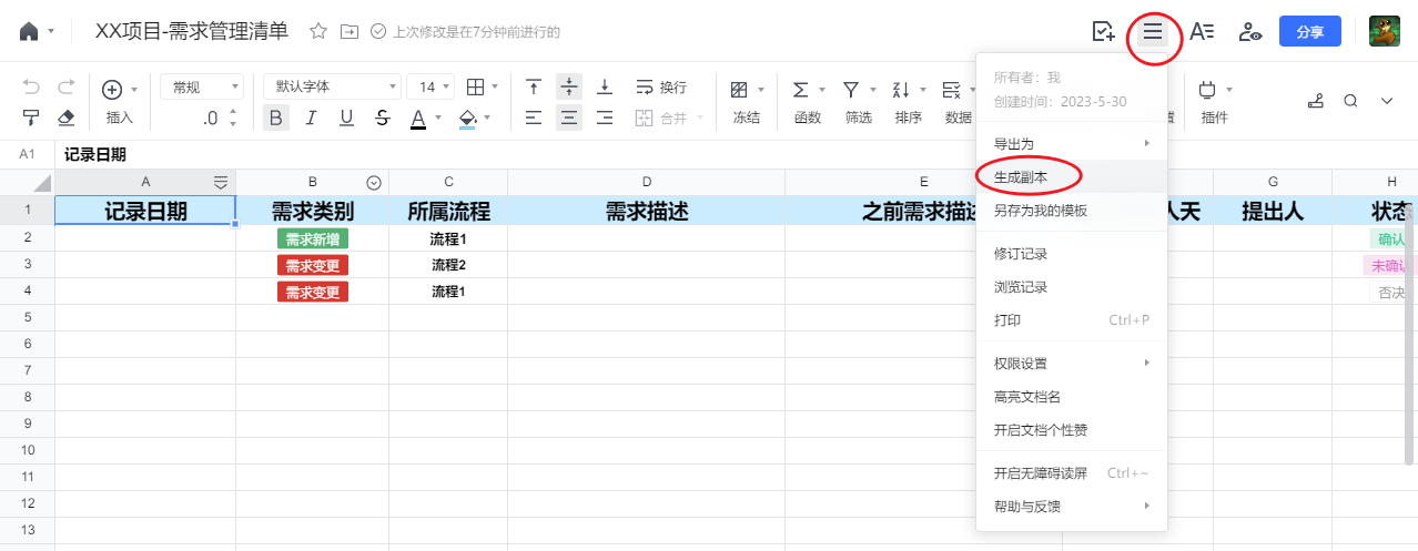

- Record every requirement change in documents
- For requirement changes that are still under discusstion, have been approved or have been denied, we should record them in documents to the extent possible. If conficts arise with the Client, these records can be serve as evidence for determining both sides’ responsibilities.
- It’s recommended to utilize online ducuments in instant communication software. They are easy for both sides to check, edit, and export as part of project delivery documents.
- The format for requirement change documents can be created by referencing the following template, or you can duplicate a copy from this online Tencent Document(【腾讯文档】XX项目-需求管理清单) to your own account:
Record Date | Category | Workflow | New Description | previous Description | Man-days Estimate | Proposer | Status | Confirmer | Notes |
20XX-XX-XX | Requirement Addition | Workflow A | Confirmed | ||||||
20XX-XX-XX | Requirement Change | Workflow B | Pending | ||||||
20XX-XX-XX | Requirement Change | Workflow B | Denied |
