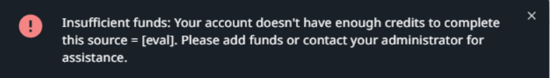

Hi everyone,
I’m facing a critical issue with my UiPath agent. It was working fine, but now it’s stopped, and I’m consistently getting the following error message:
“Insufficient funds: Your account doesn’t have enough credits to complete this source. Please add funds or contact your administrator for assistance.”
Any help would be greatly appreciated!

Hey @HectorT
It appears your agent has exhausted the daily credits for LLM calls.
Check this: Agents - Licensing
The best option now is to wait for the refresh and rerun the agent the next day.

Hi @HectorT
Welcome to UiPath,
Your account has no remaining credits to run the robot. Check in Admin → Licenses for usage. You need to add more credits.
if you’re using a community plan, consider upgrading if your usage is consistently high
If you found helpful please mark as a solution. Thanks
Happy Automation with UiPath

This is more or less what the LLM wrote to me, but I have enough credits.

Thank you. Indeed, it’s working normally again today.
